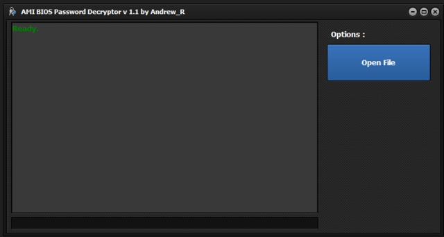

levi990e attached the following file:
amidecryptor.zip [2.17MB / 267 Downloads]
amitsedecrypt.zip [450.07kB / 172 Downloads]
uefitool_ne_a68_win64.zip [6.72MB / 225 Downloads]
