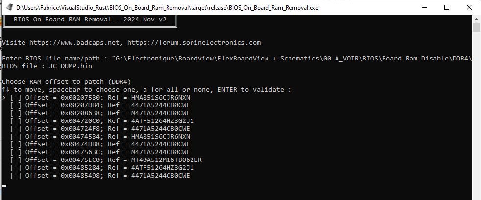

Posted 12 hours ago
levi990e attached the following file:
bios_on_board_ram_removal.zip [100.18kB / 0 Downloads]
