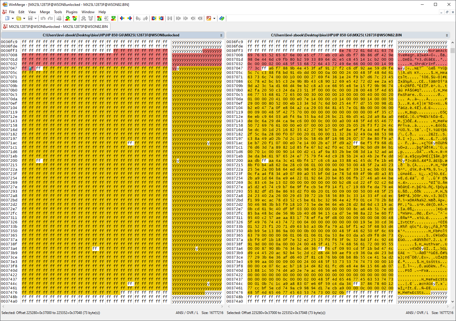

HP Elitebook 850 G6
levi990e attached the following image:

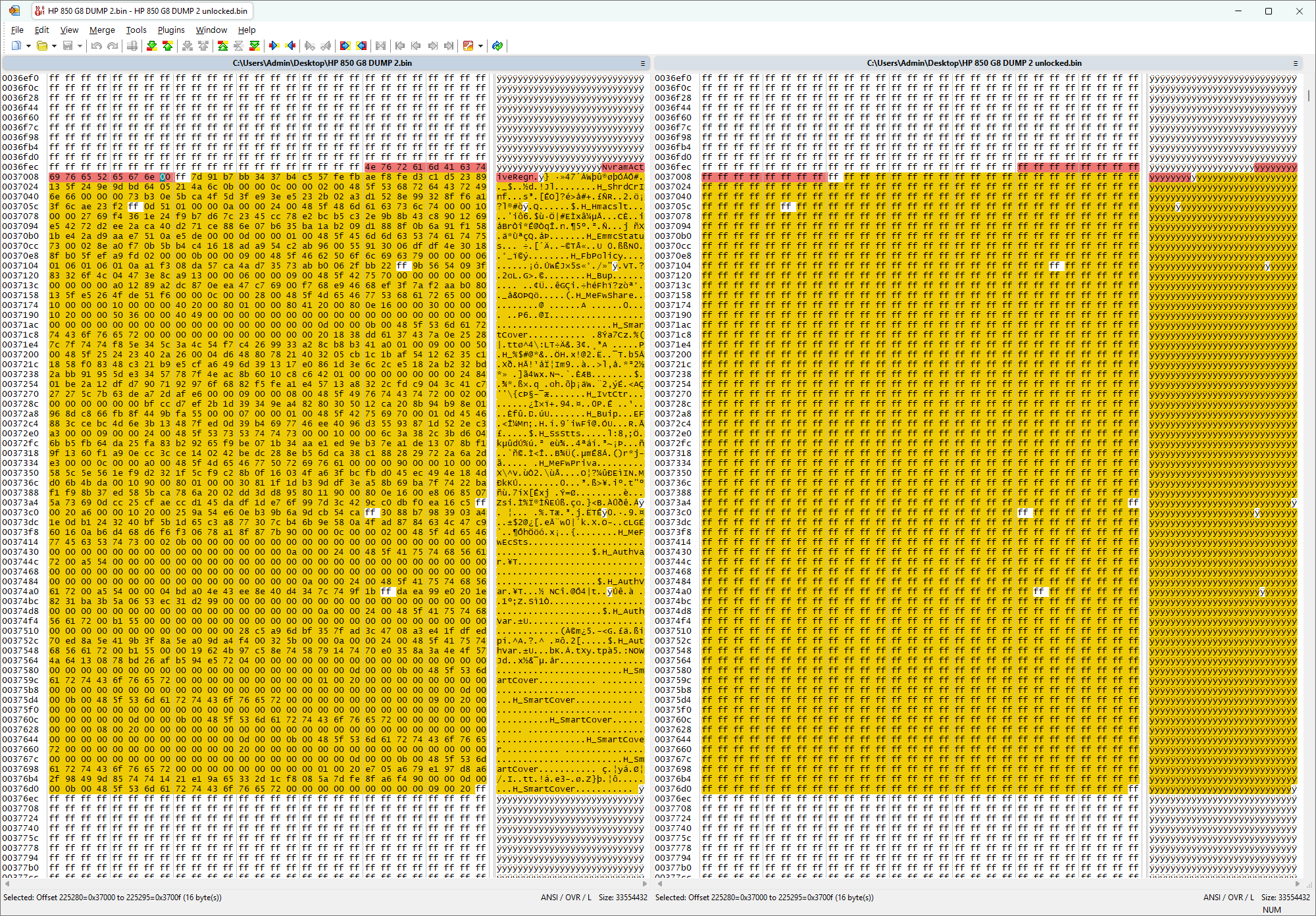

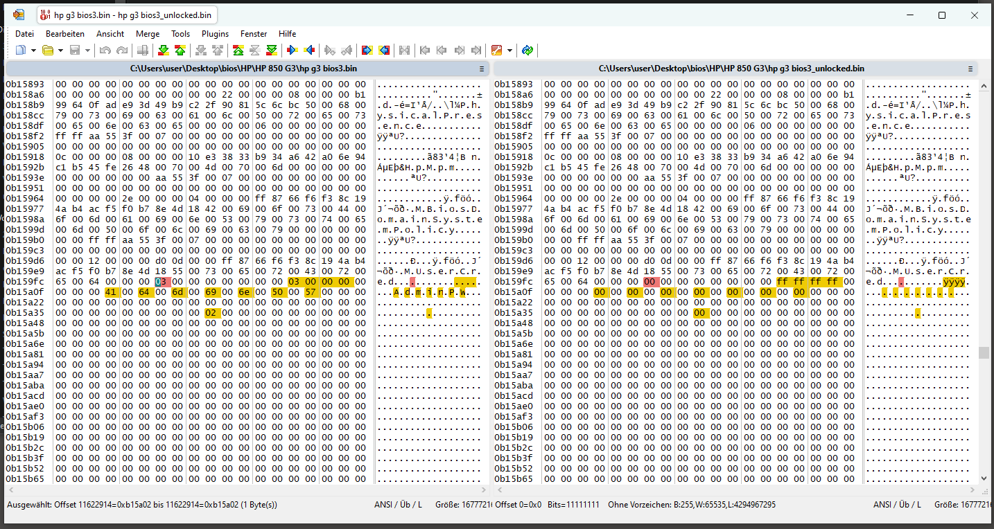

HP Elitebook 850 G3
Edited by levi990e on 22-12-2024 16:46, 1 year ago

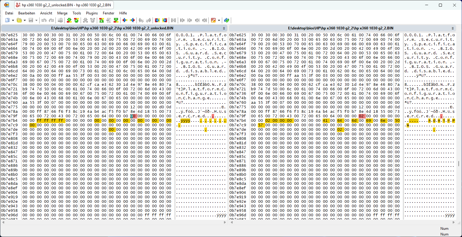

hp x360 1030 g2

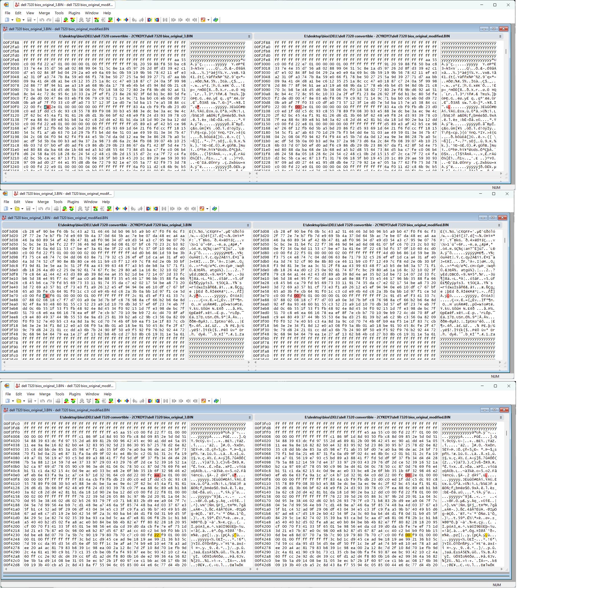

dell 7320 detachable
Edited by levi990e on 15-07-2025 08:11, 9 months ago

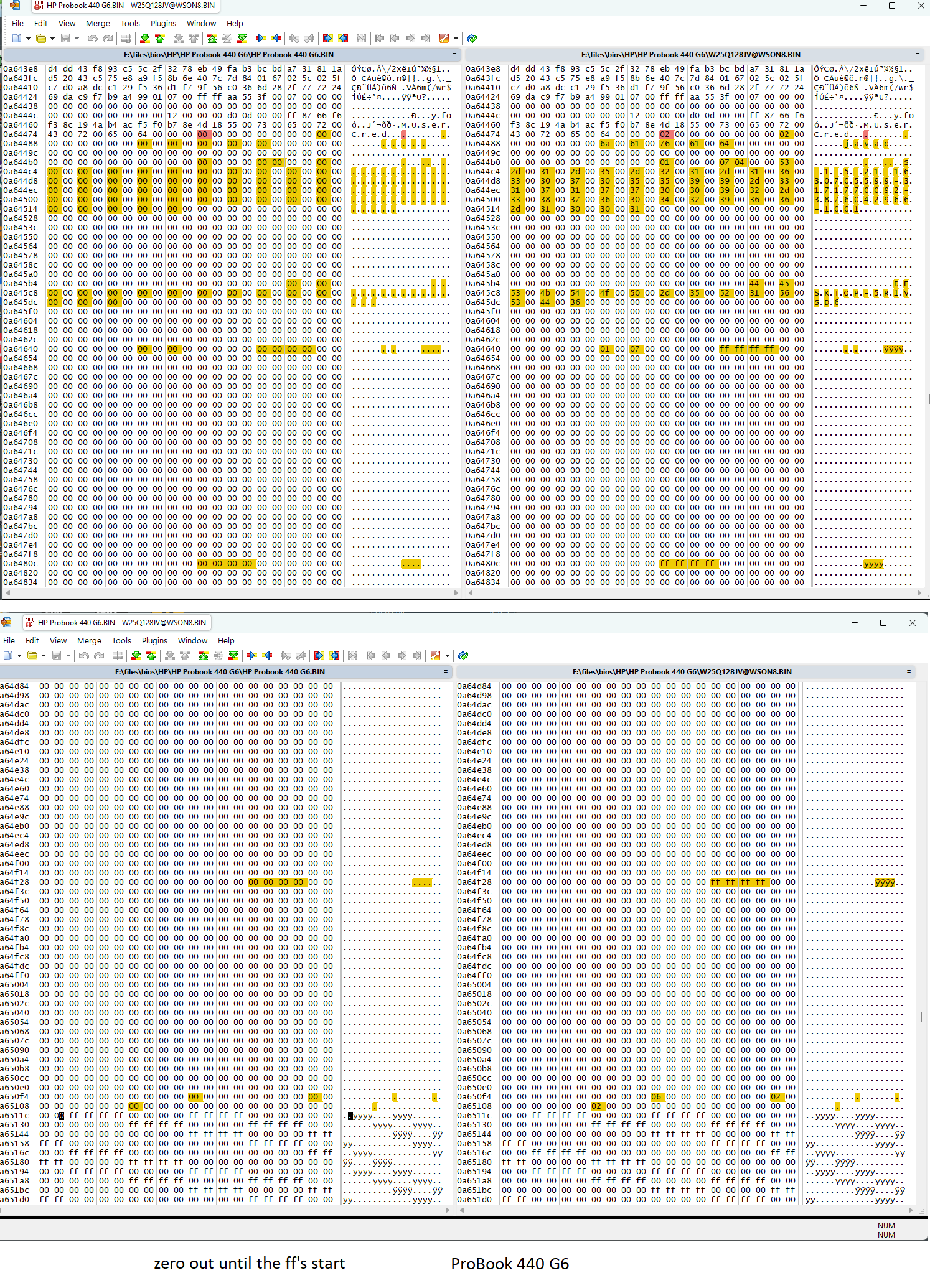

hp probook 440 g6

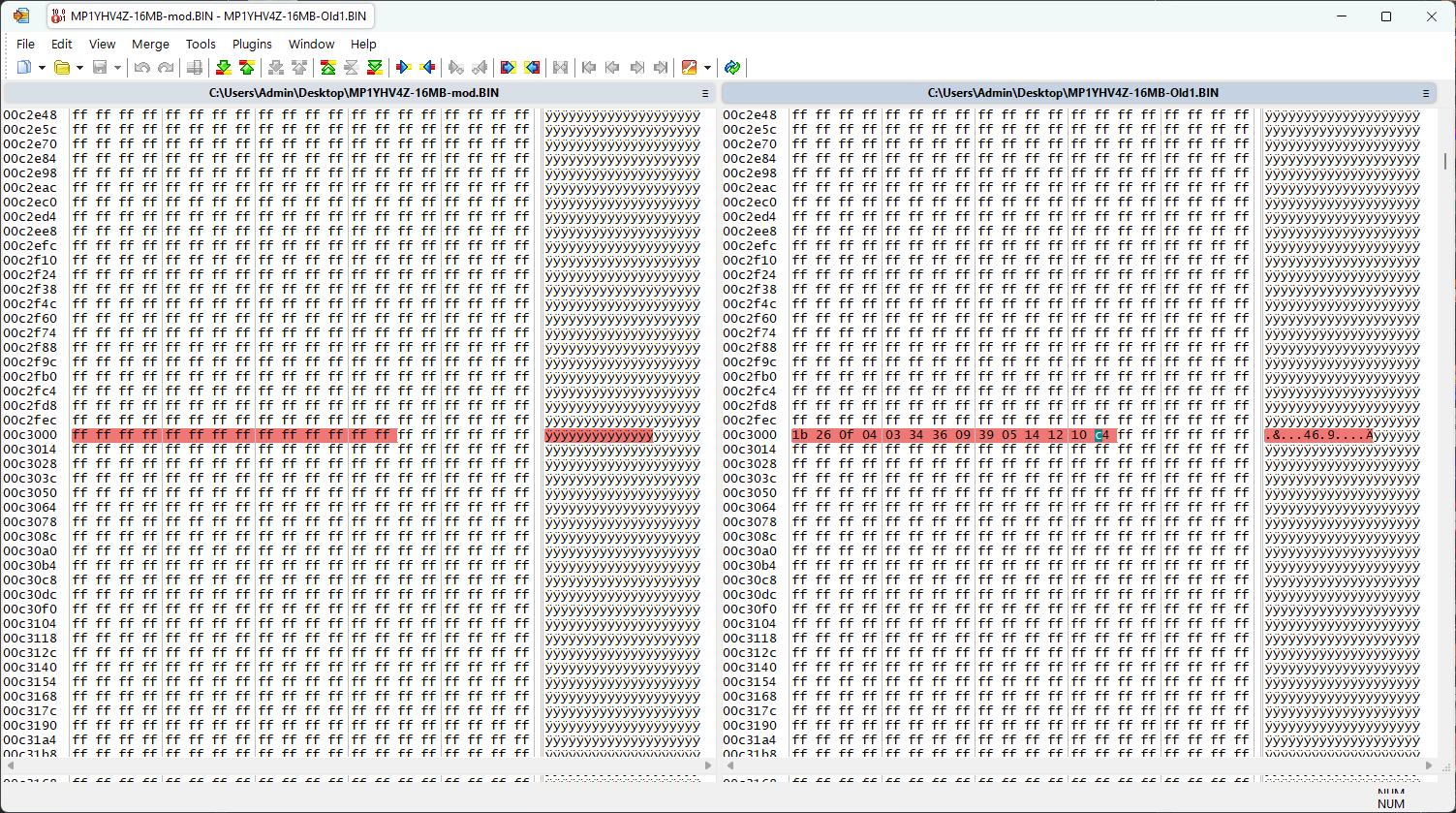

Lenovo Thinkbook 15 G2 ITL
Edited by levi990e on 02-09-2025 09:09, 8 months ago
